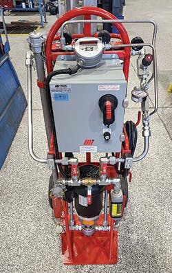

Figure 1. This filter cart has an internally plumbed particle counter to display ISO/SAE counts and temperature. This allows for real-time monitoring and verification of lubricant integrity during equipment installations and servicing. (Image courtesy of Motion)
  • Contamination Monitoring Sensor—This sensor is designed for oil-lubricated rotating machinery and will provide a sensor-calibrated ISO 4406 code to elaborate on the particle sizes present within your oil. Ideally, it allows you to see the size distribution and understand the next action to be taken (see Figure 1). Filtration is a common action item.
