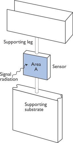

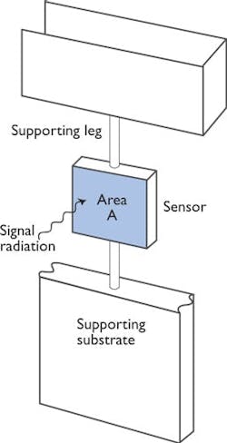

Thermal sensors
The principle of a thermal infrared sensor is shown in Figure 2. A tiny, thin platesometimes called a plateletis fabricated on a silicon chip. The platelet is 50 microns square by 0.5 micron thick. Even smaller sizes are under development. Long thin support legs and a surrounding vacuum isolate it from the substrate. Focusing low-level thermal radiation from a target onto the platelet heats it. The higher the target temperature, the greater the focused radiation and the higher the platelet temperature, which is measured by the change in resistance of a resistor deposited on the plate. This is the basis for the microbolometer sensor.
Figure 2. The principle of a thermal infrared sensor.
The temperature also can be measured by a thermocouple with the hot junction on the plate and the reference junction on the substrate. This is the basis for the thermoelectric sensor. Temperature also can be measured by an electrical capacitance effectthe basis for the pyroelectric sensor.
