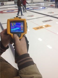

Olesen and crew monitor conditions with hand held equipment, using a Fluke Ti32 Infrared Camera for their initial assessment of the space and for spot checks. "Thermography is an extremely helpful tool because if we are able to look at a space with a thermal imager as soon as we arrive, we can instantly see things that may not reveal themselves for days, such as airflow issues, or cooling problems in the floor. We are always better off if we can anticipate an issue rather than reacting to a problem."
The ice crew also will use a Fluke 62 MAX IR Thermometer and 971 Temperature Humidity Meter for continual environmental quality checks, and a Fluke 52 II Dual Input Digital Thermometer ("Old Reliable," says Olesen) that is installed immediately on arrival and used as a baseline for the whole event.
Figure 2. Thermography helps diagnose ice surface issues quickly and non-invasively that otherwise might not reveal themselves for days, such as airflow issues or cooling problems in the floor.
