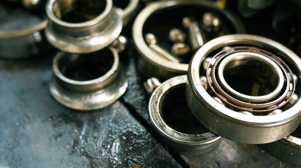

Same happens in a factory. Every time, someone comes up and shows me a bearing they replaced. I hear it almost immediately: “It overheated.” It’s said with confidence…finality. Case closed.
But if you’ve spent enough time on factory floors, tearing down equipment, looking at what failed instead of what people think failed, you start to see a different pattern. The bearing didn’t fail because of heat; the bearing failed, and heat was the result. The color left behind is not the cause. It’s the confession.
Every bearing color tells a story
When steel is exposed to elevated temperatures, it forms a thin oxide layer. The thickness of that layer changes with temperature and time, producing colors: straw, brown, purple, blue, and eventually black. Most people see those colors as evidence of overheating. They’re right, but only partially.
Those colors are a timeline. They tell you how long the bearing operated in distress, how severe the conditions became, and how far the failure was allowed to progress before someone intervened – or didn’t.

The real question no one asks: “What actually breaks the film?”
Stop asking “if heat isn’t the cause, then what is?” The better question is: Why did the lubricant film fail? Because that’s where almost every bearing failure begins. Not with heat…not with over-greasing…not with some mysterious event. With the loss of separation between surfaces.
In the field, the usual suspects are remarkably consistent:
- Contamination, especially water and fine particles
- Starvation, not excess
- Incorrect viscosity for the load and speed
- Poor lubricant delivery or distribution
- Mechanical issues like misalignment or improper fit
Notice what’s missing from that list; over-greasing! Despite how often it’s cited, it rarely shows up as the root cause when you actually analyze failed bearings in the field. What you see instead is localized starvation, channeling, or simply the inability of the lubricant to stay where it needs to be. An aggressive grease gun pump will generate pressures enough to pop out a seal, then grease is lost and contamination enters.
