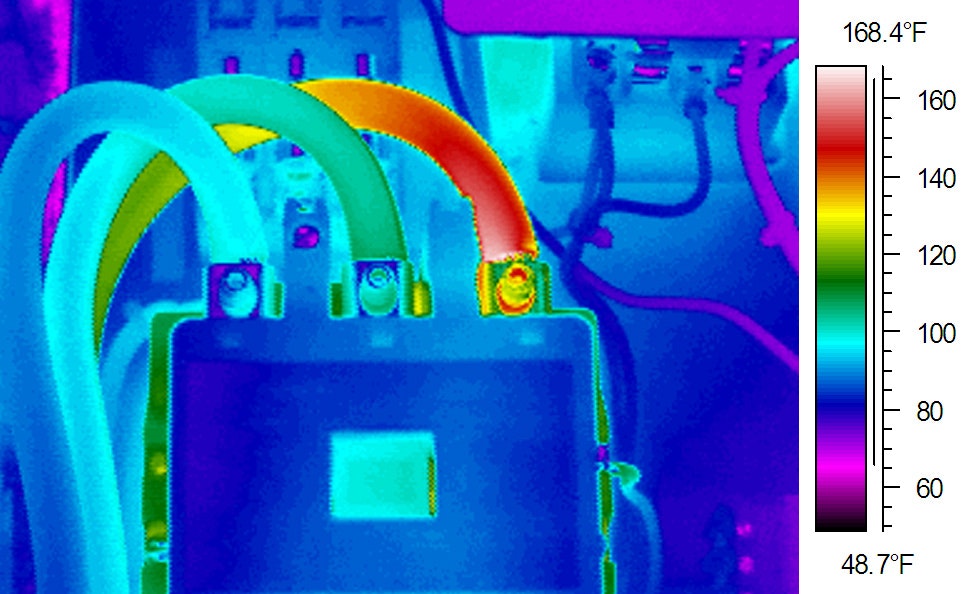

Figure 2: Electrical contactor showing a loose, overheated connection.
Infrared thermography: This non-destructive method uses an infrared camera to detect thermal patterns and measure operating temperatures. It’s useful for detecting loose or improperly terminated electrical connections, overloading, defective contacts, phase imbalances and other electrical problems. In mechanical applications, it’s useful for detecting overheated bearings; misalignment in belts, sheaves and couplings; faulty steam traps; and other anomalies that exhibit a thermal change as components degrade. Figure 2 shows a typical thermal image of a loose connection in an MCC contactor/starter.
