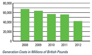

Figure 1. Generation costs dropped from almost 70 billion British pounds in 2008 to just over 40 billion in 2012.
Generation costs dropped from almost 70 billion British pounds in 2008 to just over 40 billion in 2012 (Figure 1). “Ivara helped us to achieve our vision of business excellence in process safety and asset management,” says Sedgwick. As a high-reliability organization, ScottishPower now produces consistently over long and sustained periods of time. The proactive culture is one of continual vigilance and lacks complacency. Employees act strongly to weak signals and set their thresholds for intervening very low, given the understanding of the condition of their assets. Senior management has visibility of core operational processes, which has increased confidence and assurance from board level to plant level. The result has been improved cooperation between leadership, workforce and regulatory bodies and the drive to deliver a high-reliability organization.
