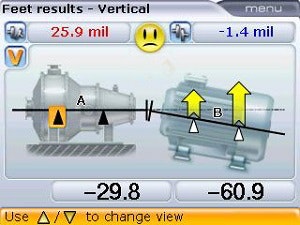

The graphical results from the Ludeca Optalign Smart alignment tool show equipment components out of alignment and the results after alignment of the equipment is completed.

As part of the acceptance and commissioning process for new assets, equipment installed by contractors during capital improvement projects (CIPs) is baseline-tested for proper alignment. During scheduled alignment testing for the new Mill Creek Grit Area process equipment, the technicians discovered that a grit tank drain pump was not correctly aligned when it was installed. Alignment results in the vertical plane showed the pump was 25.9 mils out of alignment, and 12.8 mils out in the horizontal plane.
A follow-up work order was generated, and Mill Creek maintenance workers realigned the equipment, using the OptAlign Smart tool to ensure the motor and pump were aligned within specifications. Misalignment of rotating equipment will lead to premature wear and ultimately a failure of asset components, which reduces the lifecycle of the equipment and causes a loss of process system availability. Finding and correcting misaligned equipment before equipment fails is a critical step toward ensuring that newly installed equipment remains reliable. Had this asset not been properly aligned, the cost for materials and labor to rebuild the pump would be about $3,700, with additional costs associated with the loss of service for this critical process area.
