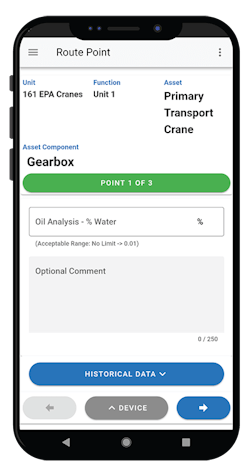

By comparison, tremendous value is gained by transitioning maintenance and operator rounds from paper-based and disconnected equipment condition information sources to handheld devices and a shared digital database. These tools are known to enable a successful walkaround inspection program and reliability culture by capturing and centralizing a new and necessary level of granularity. This way, if a failure occurs, the searchable digital database will reveal actionable history.
Continuing with the above example:
  • From lubrication-related rounds, data captured may include when and how much grease was added, the type of grease used, meaningful information about oil levels (e.g., full, half full, quarter full, or empty), oil conditions (e.g., cloudy, milky, foamy, or particulates), leak details, photographs, and related pertinent information.
  • From operator rounds, equipment reliability history is bolstered, such as whether the coupling guard was in good condition, the pump was leaking, wires were exposed, unusual odors, sounds, or sights were noticed, and equipment cleanliness.
The better rounds tracking systems also generate automated exception reports based on provided thresholds, enabling review of the issues – such as a static oil bath’s sight glass indicating a half full or lower oil level, or a suction pump bearing’s vibration amplitude exceeding a certain limit. This helps with escalating the highest priorities to work orders.
