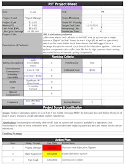

Next, we re-evaluated all the reliability projects using an evaluation form to guide this quantitative assessment (see Figure 3). The process considered costs for asset maintenance and lost opportunities, along with the remaining asset life, to generate a life cycle cost calculation. We evaluated the top 10 to 15 projects on our list in this manner, which enabled us to rank and focus our work on the projects that provided the highest return on investment in terms of both time and money.
Next, criteria that considered safety and environmental consequences, lost opportunity costs, production quality, and the cost of or payback for the project were used to develop an overall ranking. This ranking system allowed us to compare the multiple projects and associated recommendations to arrive at a relative score that could be used to evaluate and rank all projects. (Note: although safety and environmental conditions were evaluated in the ranking criteria, they were not the driving factors for this ranking, because we followed different processes to address safety and environmental issues.)
The project sheet included the project scope, justification, and action plans. The status could be selected from a pull-down menu of eight possibilities each time an update was given on the project. An action plan was also provided to outline the next steps of the project, who was responsible for implementing the steps, and the date by which they were expected to be completed. The due dates were color-coded to indicate if completion of the related goal was past due (red), was coming due within the following two weeks (yellow), or would be due in more than two weeks (no color).
It eventually became clear that the action plans provided the greatest value in the process. The highest-value projects were due to be completed sooner, so team members' buy-in was developed. For example, this system helped to refocus a young engineer who was not completing his assigned tasks. When I asked him why he was not meeting his commitments, he told me he was working on assignments based on the age of the request (per his boss) rather than on its priority ranking from the RIT team. After a quick review with his boss, we agreed to align the prioritization of tasks with the RITs, and the young engineer began to support the reliability team.
We also developed a list of backlog projects using completed project evaluation sheets. We would generally evaluate one or two new ideas during the first 10 minutes of each meeting. This provided the team with a ready file of ranked projects that we could use to replace the projects on our Top 10 list that we completed. During our review of new projects, if we identified a project likely to rank among the top three on our list, we would bump other projects on the list down a notch.
