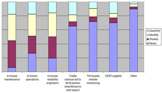

Figure 1. A 2014 Plant Services survey found that PdM data is being analyzed around once a week by in-house maintenance, operations, and reliability engineers and is not commonly made available to OEM suppliers or other third parties.
Much also depends on plants' willingness to share their data or at least to invest in maintenance as a service (MaaS) offerings. In Plant Services' 2014 survey on PdM implementation, only 15% of respondents said that they shared data from their PdM systems more than once per quarter with third parties via remote monitoring technologies, and 71% said they had no plans ever to share these data with an OEM supplier (Figure 1). Furthermore, although 20% of respondents indicated that they were using some form of embedded PdM intelligence from equipment suppliers, more than double that share said they had no plans to deploy this sort of technology (45%).
