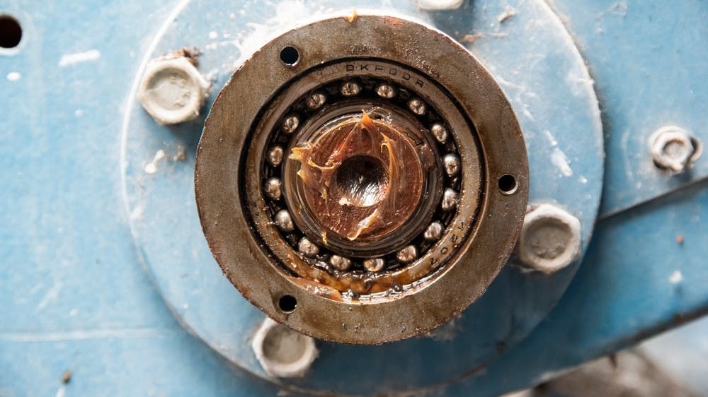

“It was over-greased.”
It is an explanation that tends to be appealing because it is straightforward, easy to communicate, and appears to offer a clear cause, but in practice it is also one of the most consistently inaccurate conclusions drawn in the field.
After more than two decades examining bearing failures across thousands of machines, I have yet to encounter a case where over-greasing was the true root cause of failure. I have seen heat generation. I have seen seal damage. I have seen inefficiencies introduced into the system. However, I have not seen a bearing reach the end of its functional life because excessive grease alone caused its failure. What I have seen, repeatedly and across industries, is something fundamentally different.
The bearing did not fail in isolation, but rather as the final expression of a system that had already moved into a failure condition.
The fundamental error: Treating the bearing as the problem
A bearing is a precision component operating within an environment that is rarely held to the same level of precision.
The bearing is expected to carry load, maintain alignment, sustain a lubrication film, reject contamination, and operate across varying temperatures and speeds, all while depending on installation quality, operating discipline, and human decision-making. When failure occurs, the tendency is to isolate the component, remove it from the system, and assign causation based on what is visually apparent.
Spalling, pitting, discoloration, and fracture are identified and documented, but these are not causes in themselves. They are the physical manifestations of mechanical conditions that have been developing over time, as well as a delay in human decision-making when the data suggests that the system is at risk of failure.
