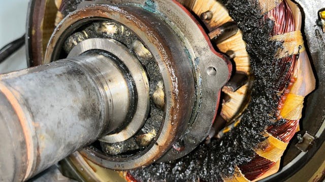

Cross-contamination is a fact of life in industrial lubrication, but it brings with it a poorly understood and costly problem: certain greases, especially PFPE/PTFE and silicone-based types, thicken dramatically when exposed to hydraulic oils, gear oils, or incompatible greases. This thickening impairs flowability, clogs lubrication paths, and accelerates failure. Understanding the mechanisms behind this phenomenon helps prevent downtime and protects critical assets.

Grease thickening upon contamination is a physical phenomenon rooted in base oil compatibility and thickener interactions, not chemical reactivity. While PTFE itself remains inert, incompatibility with hydrocarbon fluids or dissimilar greases results in flow loss, asset failure, and unplanned downtime. Understanding these mechanisms equips engineers to make informed decisions that protect uptime, reliability, and safety.
When thickening occurs from contamination, lubrication flow is restricted through lines and bearings, starving seals and bushings of lubrication. Friction increases, operating temperatures rise, and accelerated wear or catastrophic failures follow.
