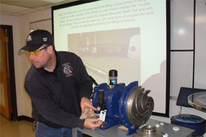

Phase 2: Lubrication management training underway
Figure 1. Employees appreciate and are responsive to the four-hour hands-on class that addresses the “how” and “why” of lubrication management.
With Phase 2 training kicking off recently, I’m hoping to see similar results and successes as we continue along our journey. So far, feedback on Phase 2 is good; folks really appreciate the hands-on aspect of this phase (Figure 1). People are especially responsive to the four-hour class that addresses the “how” and “why” of lubrication management. We go into great detail discussing why lubrication cleanliness, handling and monitoring are so important as well as the damage that contamination can have on the entire business operation.
I’ve been following up with crews after training to gauge the effectiveness of the class, and it’s apparent they aren’t only more aware and prepared to perform the activities, but they also understand the reasons for and the importance of each process. Our sample size of those who have completed Phase 2 training is relatively small, but it’s apparent how much more effective our training is now compared to even just a few years ago. Looking back, it’s scary to realize just how far off we were and how much we were at risk of equipment failures. Essentially, we were asking inadequately trained folks to perform lubrication tasks using improper equipment, and that was obviously putting us at major risk for failures.
