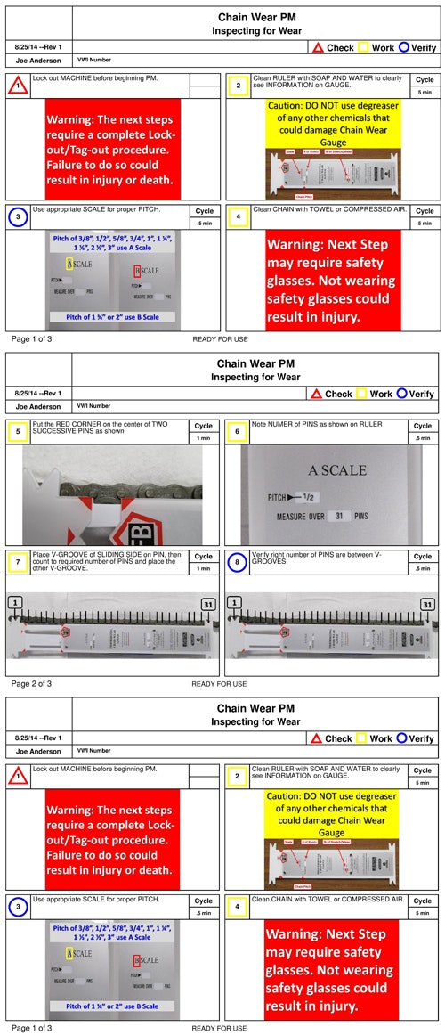

How to optimize: Inspections are one of the most important PM types. It is critical that defects are identified as early as possible to give you time to plan and schedule the work. It is also important that the mechanic has certain tools to use during the inspection. For example, if the activity is to check the chain for elongation, it is critical that the mechanic has the tools and training to execute what you are asking.
A great way to do this is with the use of a chain wear gauge. So now, on your inspection PM, where the activity states to check the chain for elongation, you would put “see attached procedure.” With it you will have the procedure on how to check the chain for wear, with the set standard of an acceptable range of wear, along with the next steps if anything were outside that range (Figure 1).
Figure 1. Example chain wear inspection PM.
