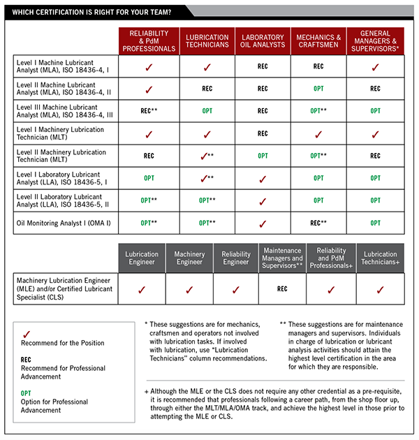

Consult this table to identify which development opportunities fit your career goals and fill gaps in your skill set.

The following tables break down the areas that each certification embodies, the required work experience, and the required/suggested training class length.

Machinery Lubrication Technician - MLT
Level I - Targets in-plant technicians responsible for daily lubrication tasks, including oil changes, top-ups, greasing bearings, lubricant receiving and proper storage and care of lubricants and dispensing devices. 1+ years work experience, 16 hours of class hours.
Level II - Targets in-plant technicians or engineers responsible for managing the lube team, selecting lubricants, troubleshooting abnormal lubricant performance and supporting machine design activities. 2+ years work experience, 24 hours of class hours.
Machine Lubricant Analyst - MLA (ISO 18436-4)
Level I - Targets in-plant technicians responsible for the daily activities associated with lubrication tasks and basic lubricant analysis for machine condition monitoring, including, oil changes, top-ups, greasing bearings, lubricant receiving and proper storage and care of lubricants; dispensing devices and basic oil sampling, contamination control and problem detection. 1+ years work experience, 24 hours of class hours.
Level II - Targets in-plant technicians responsible for the daily activities associated with lubricant analysis for machine condition monitoring, including sampling, sample management, performance of simple on-site tests, managing test results and performing simple diagnostics. 2+ years work experience, 24 hours of class hours.
Level III - Targets in-plant technicians and engineers responsible for managing the lubricant analysis function. Tasks include team management, test slate selection, setting alarms and limits, sampling system design, instruments and software selection and advanced diagnostics. 3+ years work experience, 24 hours of class hours.
Laboratory Lubricant Analyst - LLA (ISO 18436-5)
Level I - Targets laboratory technicians performing daily activities, according to established ASTM procedures associated with testing of lubricant samples. Tasks include receiving and handling lubricant samples, performing tests, reporting results and inspecting data from individual test methods. 1+ years work experience, 24 hours of class hours.
Level II - Targets senior laboratory technicians, laboratory managers, and diagnosticians responsible for the daily activities associated with producing lubricant analysis data for machine condition monitoring. Tasks include performing test and analysis, diagnosing lubricant failure mechanism and modes instrument calibration and SPC based quality control. 2+ years work experience, 24 hours of class hours.
Machinery Lubrication Engineer - MLE
This is an engineering-level certification targeting reliability and asset management professionals with a strong emphasis in lubrication and lubricant analysis. The certification is ideal for those with daily activities associated with development, implementation and management of lubrication programs. It is intentionally structured for those with responsibility to guide and facilitate organizations in tactical step towards ISO 55001 certification. This is both an engineering and management level certification for those providing general engineering support to a user lubrication program including lubricant selection, lubrication and sampling hardware selection and implementation, overall lubrication program design, procedure development, optimizing lubricant PMs and inspection program design, lubricant analysis and troubleshooting, lubrication program metrics, training and skills remediation, and management/staff communications. 5+ years work experience, 40 hours of class hours.
Certified Lubrication Specialist – CLS
A Certified Lubrication Specialist is an individual who is designated as a “Lubrication Engineer” by his/her employer. However, it is not limited to this designation, as individuals from varied backgrounds, including sales and management, opt to become CLS certified to increase their credibility/standards. A Certified Lubrication Specialist’s core responsibilities including evaluating and selecting lubricants to use and their purchases, conducts lube surveys, trains lubricators and assembles work list, develops quality assurance and used lubricant analysis programs, troubleshoots and problem solves lubrication issues, maintains records of all application, as well as waste collection or disposal. 3+ years work experience, 32 hours of class hours.
Oil Monitoring Analyst – OMA
An Oil Monitoring Analyst is involved is a predictive maintenance professional who oversees the oil analysis program for a shop/plant. The OMA  is recommended for mechanics, engineers, operators, tradesmen, chemical managers or on-site lab personnel whose core responsibilities oil sampling, reviews oil analysis reports and performs the correct tests, and maintains overall care of equipment and maintenance actions. 1+ years work experience, 24 hours of class hours.
