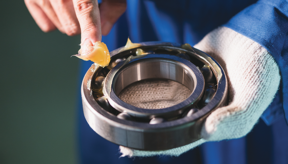

Greases
Grease is a lubricant made up of about 10% thickener (usually soap thickener) and 80% base lubrication oil, with some additives of rust and oxidation inhibitors and specific additives to provide anticorrosion, viscosity index improvement, or high film strength. The selection of additives depends on many factors, such as the need for extended life under required temperature, load, speed, and specific dry to wet conditions. Traditionally, more rolling bearings were lubricated with grease rather than lubrication oil because grease lubrication is simpler, cheaper, and easier. However, for modern machineries, particularly in medium sizes, the trend is toward modern lubrication oil systems.
Conventional greases have usually been limited to relatively lower speeds (say ranging up to 3,000 rpm). Lithium-based greases have been used in many applications due to different reasons such as resistance to small particle ingress and easy storage. For a rolling-element bearing, grease typically fills about 30% to 50% of the bearing inside cavity. Greater fill can cause higher temperatures or the grease may be forced out from the bearings.
Grease does not flush out wear particles generated within a bearing. Maintaining the proper amount of grease within a bearing is not as easily controlled as is possible with lubrication oil. Finally, grease should not be the lubricant choice when heat generated in a system should be dissipated quickly.
