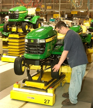

The flexibility of SmartCart’s magnetic tape overcame layout obstacles dramatically, says Dave Werkheiser, manufacturing engineer at Horicon. “The advantage of being able to just pick up the magnetic tape and change the layout in a matter of minutes allows us to change an entire line over a weekend,” he explains.
In February 2005, Deere ordered a single unit to test as a first step in receiving design approval to implement a production changeover at Horicon. Later, six additional carts were added to the prototype build and 56 more AGCs joined the mix during the summer. By the fall, final approval and acceptance testing had to take place before full production was undertaken. This included functional safety testing, component repair procedures and the setting up of in-line and off-line charging stations.
When the SmartCart line installation was finally optimized and completed with 76 carts, other AGC features helped to streamline the Deere production line. Unlike the earlier AGVs that had trunnions to rotate the tractor bodies for access, the company mandated top-down assembly for ergonomic reasons. The SmartCart’s hydraulic lift capabilities made it possible for operators to tailor the cart height for individual operations, raising or lowering the tractor bodies to the proper height for optimum assembly operations. For the most part, all the ergonomic concerns were addressed, says Werkheiser.
