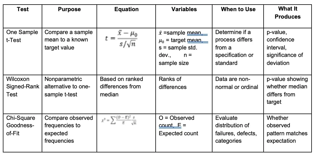

Comparing one group to an expected value: Hydraulic fluid viscosity
Sometimes the question is whether a process differs from a known target, specification, or historical benchmark. In these situations, there is only one group of observations, and the comparison is between what was observed and what was expected (see Figure 1).
Take, for instance, a lubricant blending facility. They may specify that the viscosity of a finished hydraulic fluid should average 68 cSt at 40°C. Twenty-five samples are collected from production and analyzed. The question is not whether the samples differ from one another. Variation among the samples is expected. The question is whether the average viscosity differs from the target value of 68 cSt.

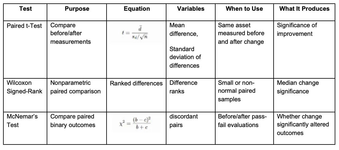

Example 2: Precision Lubrication Program
Compare motor temperatures before and after implementation using a Paired t-Test.
Step 1: Define the comparison.
The comparison is between the same motors before and after the lubrication program.
Step 2: Define the response variable.
The measured outcome is motor operating temperature.
Step 3: State the question.
Did the precision lubrication program reduce motor temperature?
Step 4: Select the test.
Because each motor has a before and after measurement, the data are paired. A Paired t-Test is appropriate.
Step 5: Interpret the result.
If the average temperature difference is statistically significant, the program likely produced a real improvement. If not, the apparent reduction may be ordinary operating variation.

Comparing two paired groups: Different states of the same machine
Sometimes the comparison is not between different populations but between the same population measured twice (see Figure 3).
A plant installs a kidney-loop filtration system on a hydraulic reservoir and wishes to determine whether cleanliness improved. The cleanliness measurements before filtration and after filtration are linked because they come from the same reservoir. Similarly, a maintenance team may measure vibration before and after laser alignment, energy consumption before and after an optimization project, or leak rates before and after a seal replacement.
The comparison is not between different machines. It is between different states of the same machine. Because the observations are naturally paired, the statistical analysis must account for that relationship.
One of the most common mistakes in industry is treating paired data as independent data. Doing so discards information and often obscures the true effect of intervention.

Example 5: Laboratory Calibration Verification
Compare measured viscosity against a certified reference value using a One-Sample t-Test.
One set of laboratory measurements is compared against a known certified value.
The measured outcome is viscosity.
Is the laboratory’s measured viscosity significantly different from the certified reference value?
Because one sample mean is being compared to a known value, a One-Sample t-Test is appropriate.
If the result is significant, the instrument, method, analyst, or calibration system may require investigation. If the result is not significant, the laboratory result is statistically consistent with the certified value.
