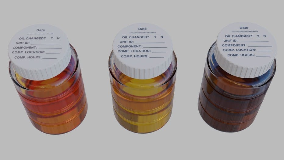

Chain-of-custody failures in plants are rarely dramatic. In fact, most plants break the chain without realizing it. These failures are small, and familiar, and often well-intended.
  • A sample bottle set on a bench during shift change.
  • A label that almost matches the submission form.
  • A cooler left unlocked because “it’s inside the plant.”
  • Three people handling a sample because everyone is trying to be helpful.
ASTM D4840 reads like a catalog of these quiet failure modes, not because the standard is theoretical, but because it is written by people who have seen data collapse under scrutiny. Most of the time, nothing happens…until it does.
