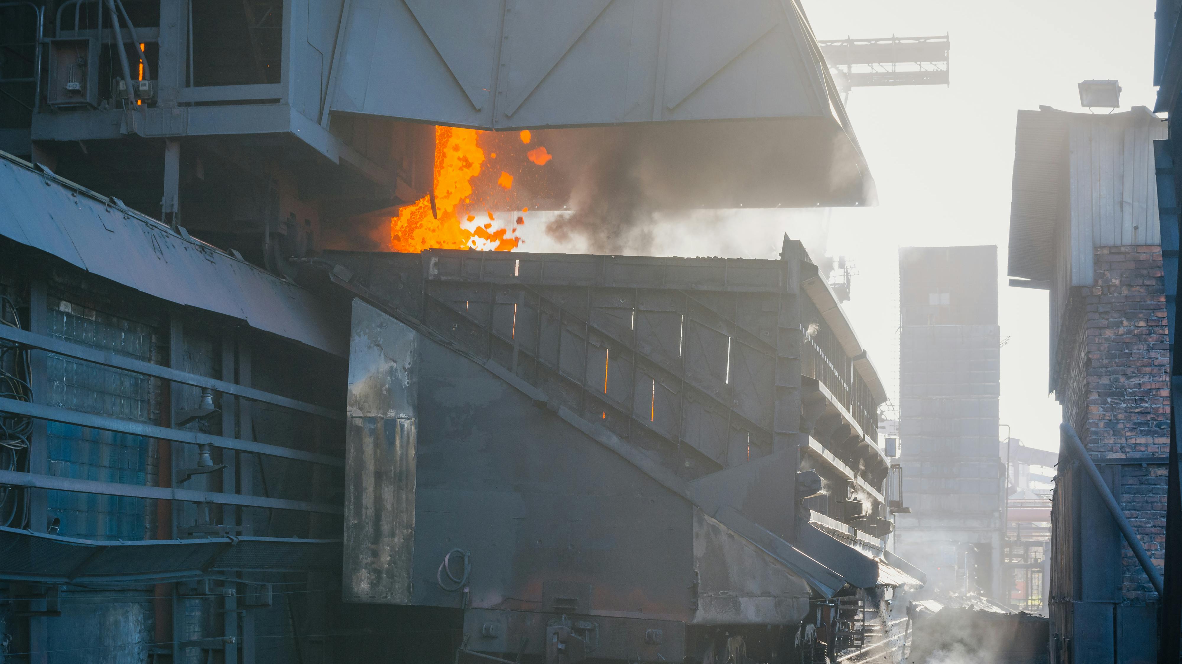

On the day of the incident, a U.S. Steel supervisor decided to exercise the Battery 13 isolation valve to confirm that it operated correctly. The supervisor arranged for MPW contractors to use a pump truck to apply pressurized water to the valve.
While applying pressurized water to the valve's seats, the workers closed or nearly fully closed the valve's double gates, creating an enclosed space between the gates. The pressurized water filled the space inside the valve and caused pressure to increase beyond the valve's ability to contain it. The valve then failed catastrophically, releasing toxic flammable coke oven gas into the surrounding area. Within minutes, the released gas ignited and exploded.
The failed valve was made from cast iron and was more than 70 years old. It was originally manufactured in 1953 and refurbished in 2013. CSB noted that cast iron is widely recognized as a brittle material and that numerous safety publications either prohibit or warn against using cast iron equipment in certain hazardous applications, including for flammable substances such as coke oven gas.
The explosion occurred in the transfer area between Batteries 13 and 14, where multiple buildings were routinely occupied by employees. The buildings were located less than 20 feet directly above the coke oven gas piping that was the source of the release. None of the buildings were designed or built to withstand an explosion, and all were catastrophically damaged.
