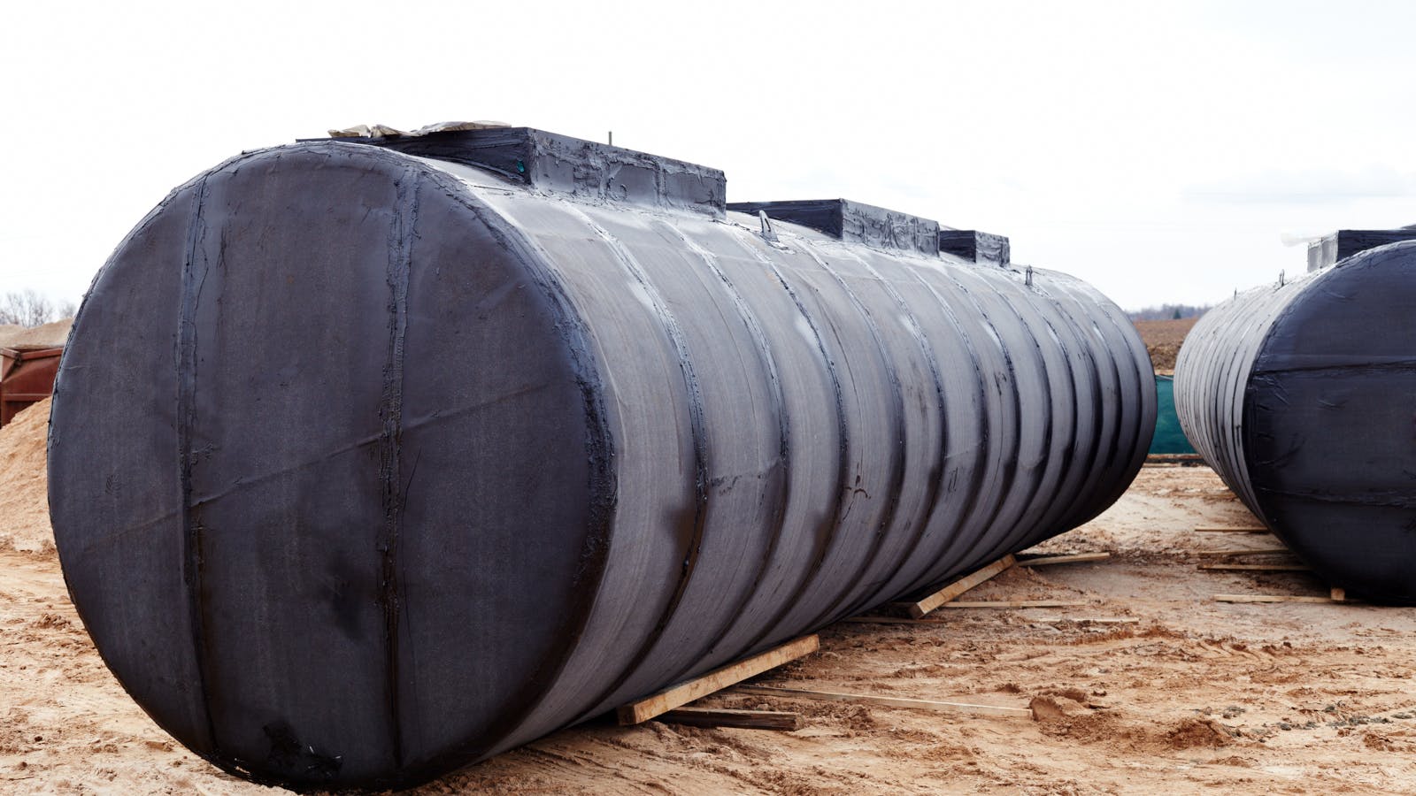

According to their website, PCE specializes in maintenance and cleaning for petroleum tanks, including lining, repair and restoration services, along with services to remove accumulated contaminants from above ground and underground storage tanks.
OSHA’s March 3 report says an employee of PCE entered a fuel storage tank and was fatally exposed to benzene and toluene at a worksite near Lake Worth, Florida. Local new source CBS 12 reported that one of several workers suffered an unspecified medical emergency while performing maintenance on a subterranean gasoline storage tank 15 feet underground.
PCE’s safety violations, OSHA said, include failing to failing to develop and implement a permitted space entry program to ensure workers were appropriately qualified to work in small spaces, ensure authorized workers were informed of workplace hazards and signs of exposure. PCE was also deemed in violation of allowing employees to enter confined spaces without atmospheric evaluations or a required permit, not keeping a respiratory program for workers required to wear full-face respirators, and failing to implement a hazard communication program for chemical exposure.
