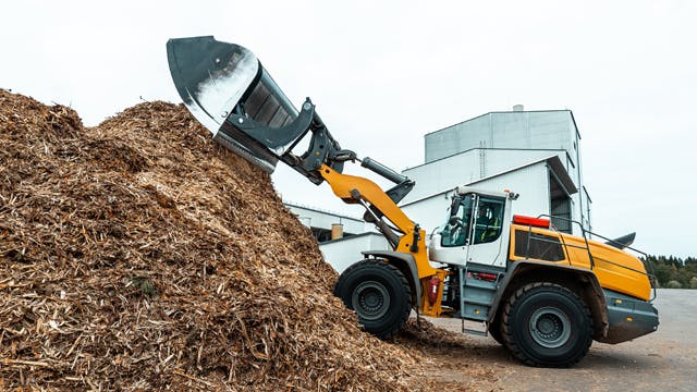

An investigation conducted by the Health and Safety Executive (HSE), Britain’s national regulator for workplace health and safety, has determined that John Brooke (Timber Treatments) Limited did not properly organize its facility and failed to prioritize the safety of its pedestrian workers. The disorganization ultimately led to the death of an employee. Thomas Brooke was walking across the yard as a wheel loader, which had its bucket raised, approached the area. Unfortunately, the shovel moved forward, colliding with Tom, who ultimately died from his injuries.
An HSE investigation found that the company failed to implement control measures that would stop pedestrians from accessing areas where various equipment like loading shovels, lorries, and forklift trucks were operating. Additionally, the company did not take into consideration the risk of operating machinery with reduced visibility, as well as failing to train and monitor employees.
