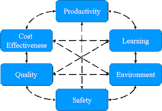

  1. How much are they producing?
  2. How much is it costing me?
  3. Am I getting good quality output on a consistent basis?
  4. Are we hurting anybody or damaging the environment in the process?
If we analyze these questions we can see that they provide the basis for all areas where physical asset management can provide a substantial impact on the companies responsible for managing them. Often attempts to define perspectives go off the rails because people are focused on how we manage the assets, rather than the impact they create for us. For example; a common misconception is to try to generate indicators in perspectives that align to functions within the company. Maintenance, operations and reliability are common groupings when this is done. There are many issues with this approach. As always we need to be conscious of the behaviors we are driving. In this scenario we have a clear cut case of pitting existing silos of activity against one another, when what we need is the realization that all areas of activity contribute to asset performance. Another frequent approach is to use break the perspectives down into the different resources required to achieve success. A focus on human resources, equipment performance, systems, knowledge and other areas is often included. Like the approach above there is one classic flaw in this, all of these perspectives cut across all areas where physical asset management can have an impact. So any measurement in one area can often be used in another area, confusing the scorecard and watering down its ultimate message. So what is the ultimate message of the Maintenance Scorecard? Basically the message is to manage the performance of the assets in a balanced fashion, so that our goals can be weighted in each of the areas where assets have an impact, in other words, to provide the company with an organizational compass for managing their physical assets. Recommended Perspectives of a Maintenance Scorecard We have already seen how the Executive branch of many companies sees their physical asset base. We can begin to classify these into perspective as below:
  1. How much are they producing? (Productivity (1))
  2. How much is it costing me? (Cost-Effectiveness (2))
  3. Am I getting good quality output on a consistent basis? (Quality (3))
  4. Are we hurting anybody or damaging the environment in the process? (Safety (4) and Environmental Integrity (5))
These four ways to view the asset base provide a pretty comprehensive picture of overall performance. However, there is still one point of view missing, and it is an area that is often forgotten or dramatically overdone. The perspective is that of Learning (6), and it measures how well we are developing our corporate information to power future improvements. Of all areas of managerial activity, asset management is possibly the most reliant on information to sustain good performance over the medium and long term. In modern asset management we suffer at both ends with regard to managing information. On one hand companies either collect far too much data on their assets, often wasting a lot of effort and time in doing so, or they collect next to nothing. (And what is collected is limited in its ability to help) Much has been written on data in asset management, the fact that it is vital for high confidence decisions and of the complexities of obtaining it. But what is not often written about is that successful asset managers will actually reduce failure data, not increase it, making this area even more difficult. On the other hand maintenance departments all over the world are leaking knowledge at a dramatic rate. Much of the experienced workers we have relied on for decades are retiring, in fact many were cut during the cost cutting that went on during the eighties and nineties, and many young people are opting for other careers other than those of engineering and asset maintenance. So the learning perspective covers a wide range of areas, but it all revolves around the management of information. (Data + Knowledge) For example; quality and integrity of data, effectiveness of training, and codification of knowledge into usable data all represent areas that we need to focus on in order to ensure that our successes are not short lived. So in summary, a maintenance Scorecard that provides a company with a balanced view of how its assets are performing will need to cover the following 6 areas of performance.
  • Productivity – How well are our asset performing? How well is our workforce performing? Is there any hidden productivity that we can unlock in any place?
  • Cost-Effectiveness – Are we getting the best value for each dollar spent on the maintenance effort? If not how can we lever even further value out of it? Note: This is not the same as low cost which is not a concept supported by the author. Low cost has a tendency to become high cost in the mid term, either directly or indirectly.
  • Quality – Are we delivering the level of quality required in terms of production? Are we delivering the level of quality required in terms of asset maintenance performance?
  • Safety and the Environment – Instead of the reactive measures of number of incidents, how can we proactively measure our exposure to risk of asset failure in these areas?
  • Learning – How well are we managing the information (data + knowledge) we are learning from today’s activities, in order to fuel tomorrow’s improvements?
