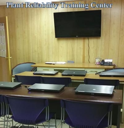

We have created a plant reliability training center to teach essential SAP skills to all of our employees (see Figure 1). We keep the class size small, usually around six people, so instructor-led training can be hands-on. Each employee signs onto the system and follows along with the tutorial, increasing the chances the learning will be retained.
Figure 1. SAP Plant Reliability Training Center
