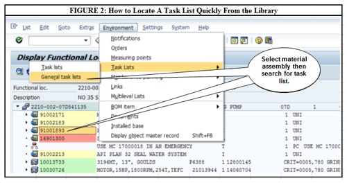

Here is where creating a task list library that is searchable, really pays off. In a previous post, I discussed the importance on using virtual assemblies, or IBAUs as we call them, to group materials. We also use these virtual assemblies to link to our task lists to our equipment; (or in SAP lingo our material assemblies.) By doing so, it becomes much easier to identify whether a given task list exists.
Let’s use the example of a centrifugal pump. We have six task lists associated with this type of equipment.

By linking only the relevant task lists to the specific material assembly, the search is narrowed considerably. The link and search function used to find relevant task lists in SAP is shown in Figure 2.
We create both general tasks lists and functional location specific task lists. Let’s say you have a general task list for a 100-hp motor change-out, but have a remote location such as a roof which requires a crane to stage the part. Your planner can copy the general task list for the 100-hp motor change-out, and add an operation to schedule and stage the crane for the motor pick. This functional location specific task list can then be added to the equipment which requires the crane to remove the motor.
