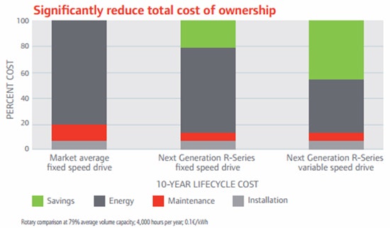

New motor technology also increases efficiency and performance. Adding variable-speed drive (VSD) options to the compressor reduces energy use at partial load by 35% by keeping the compressor running at the proper speed for the load demand, avoiding energy loss with modulating or on-off operation.
Ultimately, these savings translate to a lower total cost of ownership over the lifecycle of the compressor equipment.
Graphical images are based on Ingersoll Rand data studies.
