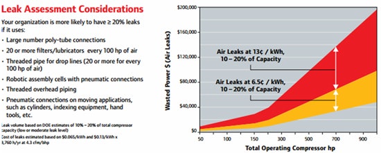

Another factor with a major impact on efficiency is leaking. A pinhole leak of 1 cfm at a 24/7 operation can cost $100 annually. Add up all of the pinhole leaks, and that’s a lot of cost spent on inefficiency. Even more costly, open blowing of a quarter-inch hole will leak 100 cfm at 100 psi, which is the equivalent of a 20 horsepower compressor running continuously to meet an artificial demand. In addition to lost costs, leaks cause all kinds of problems, including fluctuating system pressure, lost efficiency of tools and equipment, greater need for maintenance, and lower equipment service life. A good service partner will identify the leaks, mark them, assess the value of the repair, and prioritize repairs.
[sidebar id="2"]
Graphical images are based on Ingersoll Rand data studies.
