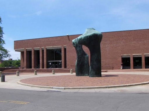

Of all of our projects in buildings designed under the Architectural Program in Columbus, the I.M. Pei library with the Henry Moore arch out front was my favorite. The 87,000 square foot building was first occupied in 1969. Designed by one of the finest architects on the planet, it exuded quality inside and out. The mechanical systems were first class. HVAC equipment included a centrifugal chiller, cooling tower, large air handlers, electric heating coils, humidifiers, pumps, control panels, etc.

  • The Library was a Massive Thermal Storage System. The brick building had concrete floors, a minimum amount of glass, and thousands of books. It was built like a cave and easy to maintain at a constant temperature. The walls absorbed heat from the sun, outdoors, lights and occupants during the day while the interior stayed cool. At night, the heat was released, cooling the walls. But the air conditioning system had been designed and operated as if it were in a building with little mass. The designers had assumed that the load on the system was directly related to outdoor temperature and humidity, sun loads, lights and occupants. The calculations to size the system had been based on that assumption, not on the actual needs of the facility. The operation ignored both the opportunity for free cooling during much of the six-month cooling season and the ability of the building mass to shift cooling loads from day to night to take advantage of the free cooling and minimize the operation of the air conditioning system.
