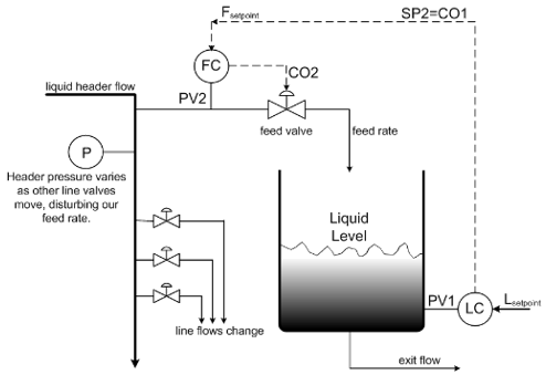

  • Immediate influence: Cascade control requires use of a secondary control loop – a small albeit essential detail that shouldn’t be overlooked. What’s more, that same secondary loop must have direct control over the final control element (FCE). As a practical example, consider Figure 1. While it maintains influence over the process the primary level controller surrenders direct control of the valve to the secondary inlet flow controller. It’s the direct manipulation of the valve by the secondary flow loop that enables it to exert immediate influence over the process and to reject the negative effects of disturbances.
Figure 1: The ability to control liquid level in a tank can be vastly improved through use of a faster secondary flow control loop.  The secondary PID loop exerts direct influence over the FCE and speeds up the process’ response to disturbances.
  • Quickness counts: If the goal of cascade control is to get a jump on disturbances, then it stands to reason that the dynamics of the secondary control loop need to be faster than those of the primary control loop.  In fact, they need to be at least 3-5 times faster. As with the tank example mentioned earlier, aligning a fast-acting flow loop with a slower-acting level loops – or some similar combination – fits this requirement to a T. Such a combination allows the quicker loop to serve as both an early detection and an early correction mechanism.
