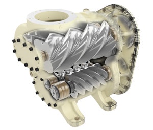

For many years, however, oil-injected rotary screw compressors have been able to deliver the typical pressures of 100–125 psig in a single stage of compression. Reasonable efficiency has been attained as the oil acts to remove heat and seal the compression module, keeping discharge temperatures around 200 degrees Fahrenheit maximum.
In an earlier blog post, I wrote about efficiency improving in newer designs as computational fluid dynamics are delivering smarter compression designs. However, I did not address the idea of increased stages delivering additional efficiency. The return on investment is usually not sufficient for small designs under 90 kW.
Above 90 kW, two-stage oil-injected rotary compressors can enjoy lower specific power and still deliver a reasonable ROI. Reducing the compression ratio by dividing into two stages allows for better volumetric efficiency. When one stage of compression is used, the higher compression ratio results in a decay of volumetric efficiency.
