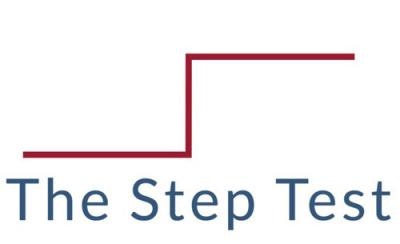

Step test
Among all of the options the step test may seem straightforward, but it presents a few notable challenges. Such a test involves “stepping” the CO from one constant value to another. It should result in the PV moving from one steady state to another steady state, and the size of the change should be large enough so that the response is clearly distinguishable from any noise apparent in the process. If modeling and tuning software is not available, then the step test may be the only viable testing option, as model parameters can be manually calculated using a trend of the associated test data. On the downside, however, because a steady state is required at both the start and the end of the test, the step test is typically time-intensive. Furthermore, any results can be invalidated if disturbances occur while testing.
