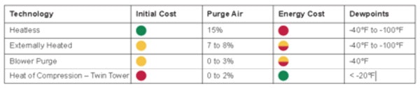

  • Desiccant dryers: For applications requiring extremely dry air, desiccant dryers can be used to provide air with average pressure dew points well below freezing, typically ranging from -40 degrees Fahrenheit to -100 degrees Fahrenheit. Most desiccant dryers have a twin tower design, and each tower is filled with a desiccant material in bead form that adsorbs moisture. As the air passes through the dry desiccant media, moisture is adsorbed by the media, thereby drying the air. For these dryers, one tower acts as the drying tower while the desiccant beads in the other tower are regenerated. Using a time-based or demand-based sequence, the towers alternate between drying and regenerating to deliver a continuous supply of dry air.
  • Heat-of-compression dryers: For applications that use oil-free compressors, another type of twin-tower desiccant dryer, heat-of-compression (HOC) dryers, can be used. In these applications, the aftercooler on the air compressor is bypassed, resulting in particularly hot air at the compressor outlet. In HOC dryers, this hot compressed air, typically between 300 and 340 degrees Fahrenheit, enters the dryer from the compressor and is directed to the regeneration tower. As air flows through this tower, heat drives moisture from the desiccant media, carrying it to an aftercooler and moisture separator where the air temperature is reduced and moisture in the compressed air condenses. Condensed moisture is discharged from the separator via a drain valve. The air then flows into the drying tower, where desiccant media adsorbs moisture from the compressed air. The air exits the drying tower with a pressure dew point similar to that of desiccant dryers.
Although dew-point performance of these dryers depends on inlet air conditions and volume more so than with other desiccant technologies, HOC dryers can be an extremely energy-efficient option because they make use of the heat that is usually extracted from the compressed air system.

Different types of desiccant dryers and decision criteria:
