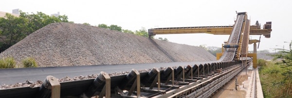

Figure 1: Processes that are slow-moving or that exhibit long dead times can benefit the most from feed-forward control.
