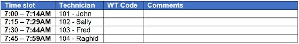

In contrast, a "wrench time" study is typically a sampling of multiple technicians across blocks of time to reach statistically significant conclusions about their activities. The following table shows a typical sampling matrix.
Table 1 – Sampling Matrix
The time slots and names are not shared with the technicians to preserve the integrity of the study. If the observer is not familiar with the technicians by name, numbers are placed on hard hats as examples. Based on the work schedule, the observer looks for Technician 101 – John – during that time slot and documents his or her observations using the wrench time code (WT code). These codes encompass activities such as direct-work wrench time, time spent looking for parts, time spent hunting for information, travel to/from the job site, and time spent waiting for equipment to become available. Other activities include breaks, lunch, meetings, etc. The observer can add additional comments, as well. It is important to randomize the sampling matrix to obtain a better sampling study. A wrench-time study conducted in this manner can last many weeks from an observation perspective to effectively sample the workforce. I’ll add that wrench-time study results can be skewed if schedules and teams are adjusted to accommodate the study, although they're likely to be skewed to a lesser extent than with a DILO stufy.
The results can be compiled in a database and reports generated from them. In this type of a study, you are not looking at individual actions but rather patterns of activity. For example, you may find the technicians gravitating back to the shop before the afternoon break and wrench time steadily dropping off until the shift ends. You would expect to see that in the final hour of the shift, but finding it before the afternoon break surprised one organization. On investigation, a business process had the planner-schedulers overestimating the job duration to avoid additional passes on the same work from their perspective. This overestimation caused the technicians to run out of work earlier than expected for any given day.
