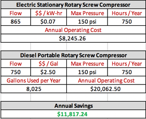

For some compressor operators, money talks. Manufacturing processes can be expensive, so reducing costs can be a very attractive factor. One of the key benefits of an electric compressor is its cost-effectiveness. Electric compressors do not require fuel, which makes them much cheaper to operate than diesel compressors. Electric compressors require only a power source to run and can be left practically unattended once they're plugged in and commissioned. The use of diesel compressors requires someone to monitor fuel-tank levels, because they can run for only about 12 hours before they need refueling. Furthermore, a diesel engine’s filters must be replaced every 250 hours – that’s every two weeks for a facility that runs 24 hours. Electric compressors can be left alone for up to 4,000 hours before maintenance is needed. That difference in maintenance levels is significant and can be a determining factor for compressor operators as both labor hours and budget dollars must be dedicated to machines that require additional maintenance.
