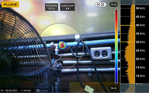

Figure 1: Sonic industrial imager detects a significant industrial welding gas leak costing $46,000 per year (Source: Fluke ii900)
My journey of discovery started when I was offered a chance to try out some new instrumentation technology. When trialing a new Fluke ii900 ultrasonic industrial imager I offered a customer a freebie leak audit so I could put the new device through its paces. The imager uses an array of microphones to detect sound signals emitted by gas leakage and overlays the signature on a video screen for easy processing. A reporting feature will calculate the approximate leakage flow based on distance and decibel information. With this information a leak auditor can quickly detect, locate, and cost out leaks of all kinds; in fact it will detect more than common compressed air leakage, as I found out.
One day when scanning a large farm implement manufacturer, it took me about an hour to find and locate about 40 significant compressed air leaks costing about $4,000 per year. However, I also noticed a few small leaks in odd colored piping. It wasn’t until later I discovered that the facility used industrial shield gasses in their welding and laser cutting operations. Curious, I asked the customer to find out how much they pay for their Argon and Nitrogen. The answer floored me!
