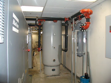

A centerpiece of the proposal was Atlas Copco's WorkPlace Systems, which fully integrates optional ancillaries such as air and condensate treatment equipment. The compact, self-contained units eliminate the problem of overcrowding in ADP's compressor room and allow for remote control. Energy management software would provide access to authorized users from remote computers running PC Anywhere.
ADP's Rivera gave Iacono the good news: he had the job as proposed if the system could be installed on a specific weekend that coincided with a planned plant shutdown. Iacono's president, John Iacono, Jr., agreed. "My crew worked two 16-hour days, said Iacono. "They removed every piece of old equipment, cleaned the room, and got two compressors on line in time for plant startup Monday morning. During the next week, they finished the installation and plumbed a totally professional and efficient compressor room."
The new system, now up and running, has made solid efficiency improvements to the Long Island operation. Even during the proxy season, only two of the four compressors a GA75FF running at 100 percent capacity and a GA75VSDFF typically running at 50 percent to 75 percent needed to be run. Overall, the system has saved ADP 125-150 hp of energy that had been wasted.
