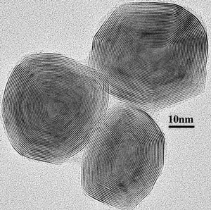

Enter nanotechnologyNanotechnology-based dry lubricants feature spherical inorganic structures (see Figure 2). The structure's geometry is referred to as a Fullerene, and hence the term inorganic Fullerene-like, or IF, nanoparticles. The sphere's structure resembles Buckminster Fuller's design for geodesic domes and is thus called Fullerene in his honor.
Figure 2. Transmission electron micrograph showing cross-section of inorganic Fullerene nanospheres. Note the multi-walled, onion-like structure of nested spheres.
In contrast to the flat plates of conventional solid lubricants that lubricate by sliding, inorganic Fullerene-like, nanotechnology-based solid lubricants have structures of progressively smaller concentric spheres, sometimes as many as 20 or more, nested one within the other. These act as miniature ball bearings that roll across surfaces, which provide lubrication. The nested spheres are analogous to the rings of an onion or the successively smaller figures in a Russian doll. This multi-wall structure offers many advantages. As the outer shell wears away during use, the resulting hole exposes an identical shell underneath. This automatically renewing, self-healing feature maintains lubricity. Evaluations by a number of independent laboratories indicate that inorganic Fullerene-like nanoparticles reduce friction, wear, galling, seizing and fretting better than conventional solid lubricants. The new lubricants also have been formulated as additives for oils and greases, as various types of anti-friction coatings and for impregnating self-lubricating parts.The scientific basis
