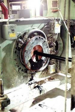

Coal-tar enamels and asphalt were the first coatings to be used on buried pipelines. They were reasonably cheap and easy to apply, and they required only a low level of metal cleaning in preparation for coating. Presently, most coal-tar systems consist of primer, coal tar, glass fabric and felt. Additional coal tar and felt layers can be used to increase the thickness.
Coal tar and asphalt systems can be applied in the shop or field, but performance has been notably better when shop- rather than field-applied (See Figure 4). If coal tar or asphalt is exposed to the sun for long periods, it may be necessary to apply a whitewash or paper on them to prevent ultraviolet degradation.
Figure 4. Pipe entering die for extrusion application of coal-tar coating. (Courtesy of Dura Bond Coating, Inc.)

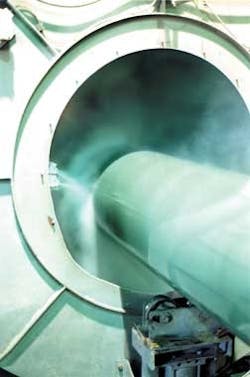

A fusion-bonded epoxy coating consists of a thermosetting powder applied electrostatically to electrically grounded metal components (see Figure 5 and 6). Heating in an oven fuses the powder into a hard, continuous, cured film. A high level of cleaning and precise application are necessary for outstanding performance.
Figure 5. Overview of powder coating chamber.
Figure 6. Applying powder coating. (Both courtesy of Dura Bond Coating, Inc.)
