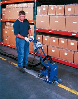

Recycling wheelblast
These systems use a high-performance wheel that hurls blast media at the surface in a controlled pattern and direction. Wheel-thrown metal abrasive scours concrete or steel surfaces and rebounds, along with contaminants, dust and debris, into a recovery chamber. Dust and contaminants move to a dust collector and blast media is returned to the storage hopper for reuse.
Horizontal wheelblast systems are used on concrete surfaces, such as floors, or steel surfaces such as storage tank floors and roofs. Vertical wheelblast systems, operated in conjunction with roof rigging systems, a winch or crane, can service storage tanks and other vertical or near-vertical steel surfaces (see Figure 1). Vertical systems are operated via remote control.
Figure 1. Recycling wheelblast systems are particularly applicable for large steel surfaces such as this storage tank. Photo courtesy of Blastrac.

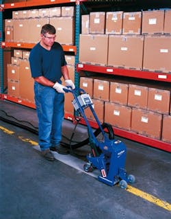

Recycling wheelblast systems are most applicable for concrete surface coating preparation and large steel surface blasting (see Figure 2). Its advantages include:
No need for containment.
Simplified waste disposal.
Cost savings from recycled abrasive.
High production rates.
Allowing other trades to work simultaneously.
Being environmentally friendly.
Reduced operator fatigue, greater operator safety.
Figure 2. Plant warehouse floors can be prepared for restriping or recoating with recycling wheelblast (shot blast) systems. Photo courtesy of Blastrac.
System use is limited to flat surfaces and equipment cost is high compared to abrasive airblasting. Also, vertical systems are not suitable for non-vertical or irregular surfaces.
