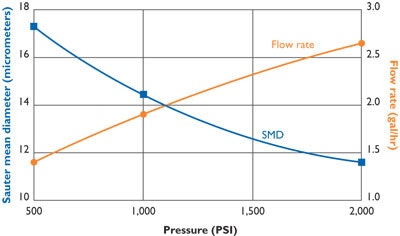

When measuring droplet size, it's important to consider distance from the nozzle and the conditions produced when billions of droplets are released almost simultaneously. Studies have shown certain nozzles operate in the "sweet spot," where just enough water is delivered with just the right force. A nozzle operating at 1,000 psi produces a 14-micron droplet size on the Sauter Mean Diameter scale (see Figure 1). With a seemingly minor adjustment, the force splitting the water into droplets loses significant strength.
Figure 1. This scale shows the point where the right amount of water, and the right amount of force are most effective.
