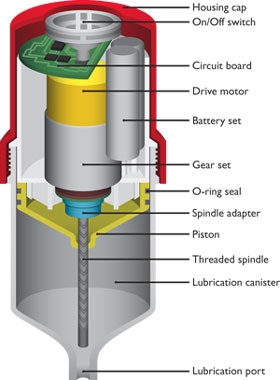

Electromechanical units
An electromechanical lubricator is a reusable, battery-powered, motorized unit with a replaceable lubrication canister. It features adjustable discharge periods and can be turned on and off with a switch. When activated, the motor powers a gear set that turns a threaded spindle to drive a piston that pressurizes the grease to 75 psi. Electromechanical unit performance is temperature-independent and discharge periods are more precise than with the electrochemical units.
The unit has two DIP switches: the settings on one correspond to the size of the grease cartridge while the second regulates the discharge duration. An illuminated LED indicates error-free operation. The electromechanical unit's self-check capability issues warnings when it's empty or has a problem delivering grease. Motor-driven automatic lubricators ensure a reliable discharge cycle and predictable grease quantities.
As an example (see Figure 1), a unit with 120 cc of grease might be programmed for three months of lubrication, and set to discharge grease every 4.5 hours, or roughly 1.33 cc of grease per day. When done properly, a little lubrication goes a long way. Yet, strategically, more frequent lubrication with lesser amounts could conceivably minimize friction and help reduce heat build up. Automatic and precise grease delivery produces many benefits, the most important of which are extended bearing life and reduced downtime. An electromechanical lubricator (See Figure 2) can be mounted in any convenient location as far as 12 feet from the bearing, although generally it must be installed upright in non-hazardous environments.

Figure 2. Cross-section of an electromechanical lubricator.
