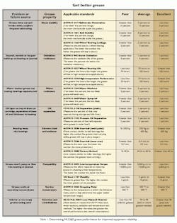

When selecting a lube for a specific application, consider the overall property of the grease. Table 1 connects problems or failure sources to grease properties. It shows a comprehensive list of generally accepted test methods and test result interpretations.
It's essential to evaluate the data before using a grease. The American Society for Testing and Materials (ASTM), a global forum for the development of consensus standards, is an excellent source for establishing purchasing standards. Organized in 1898, it's one of the largest voluntary standards organizations in the world. Known for high technical quality and market relevance, its standards provide an important part of the information that guides design, manufacturing and sales. The full text of any ASTM standard is available electronically, in print via the Web site or through Customer Service at ASTM International (610-832-9585). With generally accepted standards so readily available, there's no reason to deal with a lube vendor that isn't well-versed in the standards applicable to its products.
