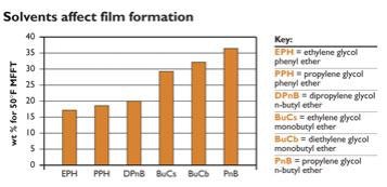

Figure 1:
Of these solvents, EPH is most effective at reducing minimum film formation temperature (MFFT).Solvents aid film formation

To facilitate the formation of a continuous film with these specialty resins, the coating must have an efficient coalescing solvent. Otherwise, the resin won't form a continuous film, allowing water to penetrate the coating.
The solvents used in a waterborne latex coatings must be water-compatible and have an affinity for the latex resin. Molecules such as dipropylene glycol n-butyl ether, propylene glycol phenyl ether and ethylene glycol phenyl ether are extremely efficient coalescents. Solvents that reduce film formation temperature -- a measure of coalescing efficiency -- can help improve the coating's protective capabilities. Figure 1 shows how different solvents reduce the minimum film formation temperature (MFFT) of an industrial acrylic resin.
