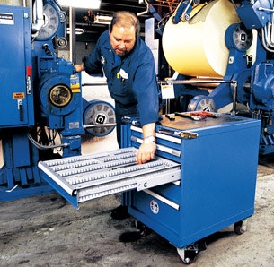

Mobile modular drawer storage cabinets deliver the flexibility and completely organized storage of high-density cabinets, while adding the benefit of convenience. With these mobile units, tools and parts can be rolled out directly to the job where they can be readily accessible to maintenance and repair personnel. These mobile workstations-on-wheels can be customized with the particular tool sets used by each craft. Repairs are performed more quickly, reducing downtime.

Mobile units can bring tools and parts directly to the job for ready access by technicians. Customize them with the particular tools of the craft to reduce downtime with fewer trips and quicker repairs.
