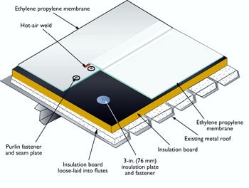

Single-ply membranes, such as hot-air-welded thermoplastic polyolefin (TPO), also can be installed directly over an existing metal roof (see Figure 1). Preparatory measures include replacing damaged metal panels and installing insulation strips between the ribs or flutes of the existing roof to enhance the roof's overall R-value and to provide a solid substrate for the single-ply roofing system. Next, installing a second layer of insulation provides a uniform, solid substrate for the roofing system.
The single-ply membrane is then rolled over the substrate and either mechanically fastened to the purlins or fully adhered directly to the insulation. The seams are welded together using hot air. Because metal roofs are usually made of relatively light-gauge panels, special fasteners must be used on mechanically fastened systems to secure them. Ensure the fastener type and spacing meets applicable Factory Mutual or local building code requirements, as well as the manufacturer's pull-out resistance requirements for wind design.
There are numerous advantages to a single-ply recover. One is that single-ply membranes are usually available in light or white colors, which, like coatings, reflect the sun's rays and thereby keep the building cooler. Another is that TPO membrane is flexible and can accommodate normal expansion and contraction easily. In addition, the cost of a single-ply recover includes the additional insulation and usually is highly competitive with a coating system making it an attractive option. Plus, many single-ply systems have a 20-year warranty, and don't have the maintenance needs typical of coatings.
The drawback is that it's more expensive than some alternatives, although the other choices might cost more in the long term. In addition, installation requires a qualified, experienced contractor who is familiar with hot-air welding and is knowledgeable about single-ply systems.
Figure 1.
In a single-ply recover, the membrane may be mechanically fastened (above) or adhered directly to the insulation.
