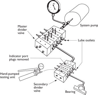

Test individual feeder dividers for blockages by using a portable hand-operated testing unit equipped with a pressure gauge and filled with clean, filtered lubricating oil. Operate the testing unit at a pressure less than 3,000 psi. Using higher pressures invites the risk of blowing the seals in the block assembly. Connect the testing unit to the lines of the master feeder and slowly operate the unit (see Figure 1). If the system won't operate freely at a pressure below 2,000 psi, go to step two. If, however, it operates freely, the source of the problem is either the lubricant supply pump or a blockage between the supply pump and the manifold.
Figure 1. Connect the testing unit to the lines of the master feeder and operate it slowly.
Step twoWith the portable tester still connected, remove each outlet plug, one at a time, and attempt to operate the manual pump at no more than 2,000 psi. If the pressure drops and the master feeder cycles freely, the blockage is downstream of the outlet being tested.When an outlet plug that corresponds to a blocked area is removed, a small amount of trapped lubricant is released as the inlet pressure at the divider valve drops. If all outlet plugs have been removed and the master feeder still won't cycle, the blockage is located in the master feeder divider valve. Disassemble and clean the valve block.
Figure 2. Remove the alternate outlet plugs in the secondary divider valve assembly. Step threeAttach the manual pump to the alternate outlet on the master divider valve that is common to the blocked area. Disconnect the supply line at the secondary inlet fitting and slowly operate the manual pump.Proceed downstream to the secondary divider valve assembly and remove the alternate outlet plugs (see Figure 2). If the pump now moves lubricant freely through each alternate outlet, you know the blockage can't be in the supply line or the divider valve. In that case, go to step four.If, on the other hand, lubricant isn't discharged through the open alternate outlets in the secondary divider valve, the blockage must be in this divider valve or its supply line. If fluid discharges through the supply line, the blockage is in the secondary divider valve assembly. Go to step five.Step four
