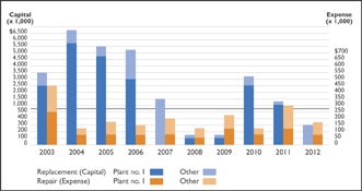

Figure 1. Roofing management software can help predict needs and schedules, and track performance year-to-year.
