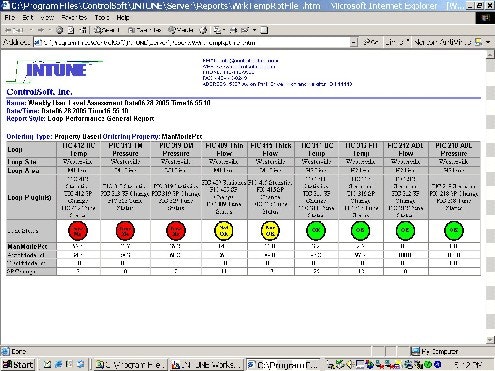

An effective strategy for identifying the loops that provide a better return on the maintenance effort could start with higher-level performance indices and move to lower-level performance indices. In other words, the maintenance effort should be focused on loops exhibiting problems and deficiencies in the higher-level assessment indices.
Available tools define and evaluate a rich set of assessment indices for the higher levels of loop hierarchy using a moving-window averaging scheme, and generate reports that rank the loops according to assessed indices. These productivity tools can support predictive maintenance strategies with minimal requirements for human experts.
Assessment indices defined for the regulatory and device levels, including standard deviation error, process variability, disturbance, noise band and optimal loop quality index, also could be used to determine the need for maintenance and prioritizing maintenance activities.
