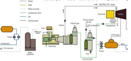

Cogeneration, also known as total energy or combined heat and power, refers to the use of a single fuel to produce heat and electricity simultaneously. In many cases, the heat produced by engine-driven generators is wasted as exhaust. Harnessing that rejected heat for re-use in boilers and dryers conserves a substantial amount of fuel. Producing both electrical and thermal energy at the same time extracts more energy from the fuel (see Figure 1). That is why cogeneration is one of the most efficient technologies for energy conservation.
Figure 1.

With the help of deregulation, feasibility studies offer many strategies for implementing a cogeneration system. For example, consider a plant that uses 60,000 lb./hr. of steam and has an electricity demand in the range of three to five megawatts. It operates 24 hours per day, but only for eight months out of the year. This isn't a viable cogeneration candidate because the cogeneration system would be idle four months every year.
Let's assume that an electricity service provider is interested in selling electricity to this plant and others in the neighborhood. The service provider could partner with the manufacturer and set up an efficient combined-cycle plant onsite to provide steam and electricity to the host. It might optimize the cogeneration system's capacity at 30 megawatts and export the excess electricity. The advantage is it provides efficient energy to a local network and unloads 30 megawatts from the high-voltage transmission lines. Such a project could be sponsored through a partnership among several plants that share electricity and heat. Ideally, the utilities should and could sponsor such cogeneration teamwork. As shown in Figure 2, the electricity cost could be as low as 4.75 cents per kilowatt-hour when the cost of natural gas is three dollars per million BTU.
